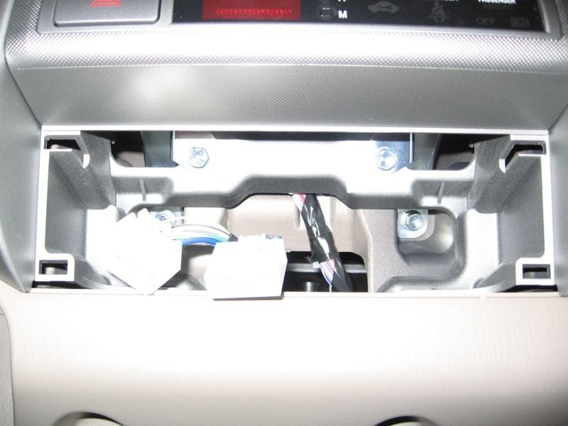

Behind Climate Controls
Behind the climate controls there are 4 10mm bolts. Two of them are easily accessible, but the other two are recessed a few cm back. These are the only "bolts/screws" that hold the stereo in place. Once these are removed, the entire unit can be unsnapped out of place CAREFULLY (this is plastic, and it can break)!
