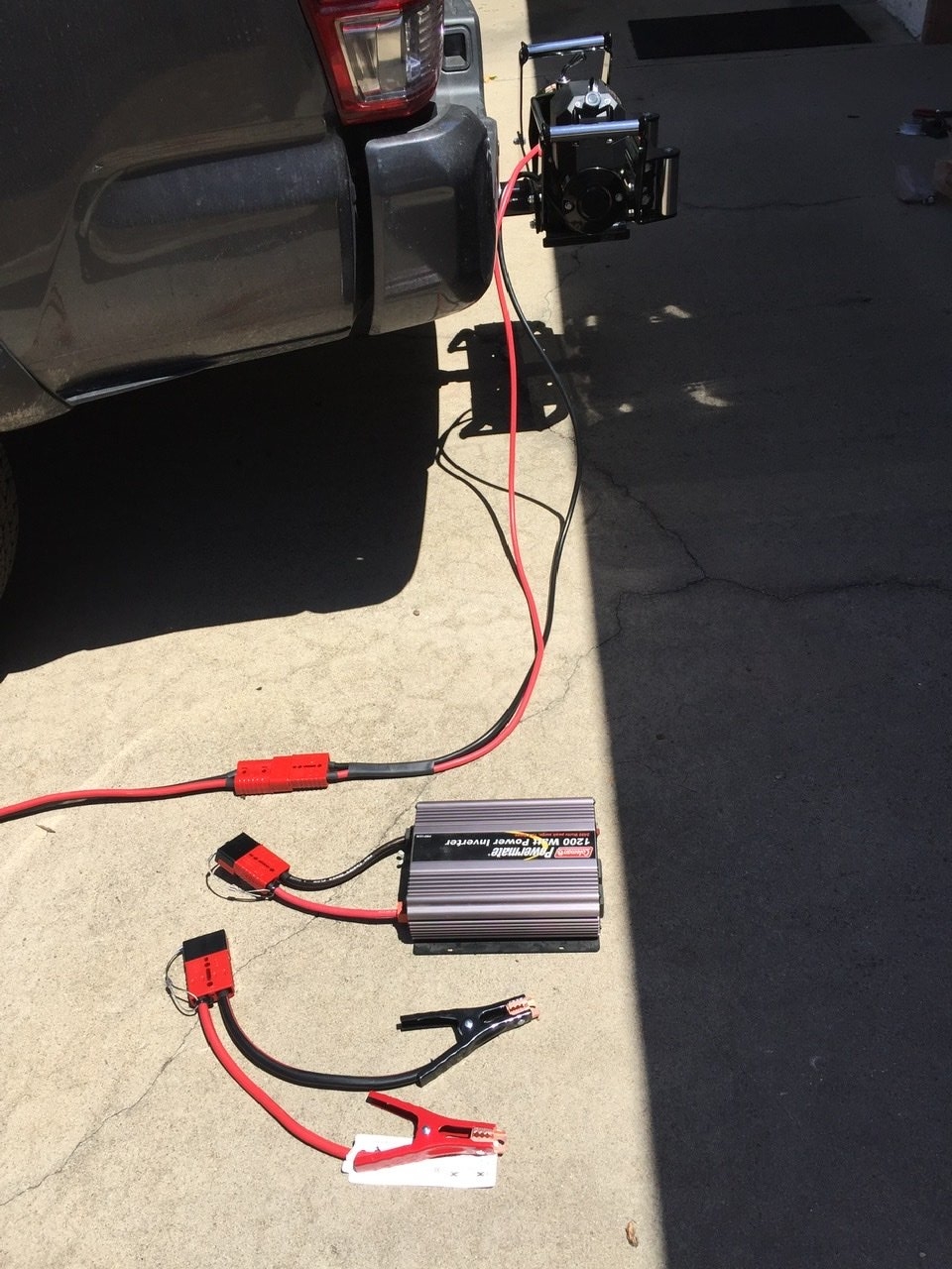

Installed Anderson SB175 connectors to both ends of a 25’ 4 ga jumper cable. Allows cable to connect with SB175 connector on HD bus bar to power rear winch, inverter, or jump a vehicle.
