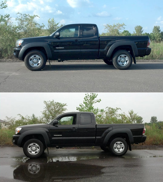

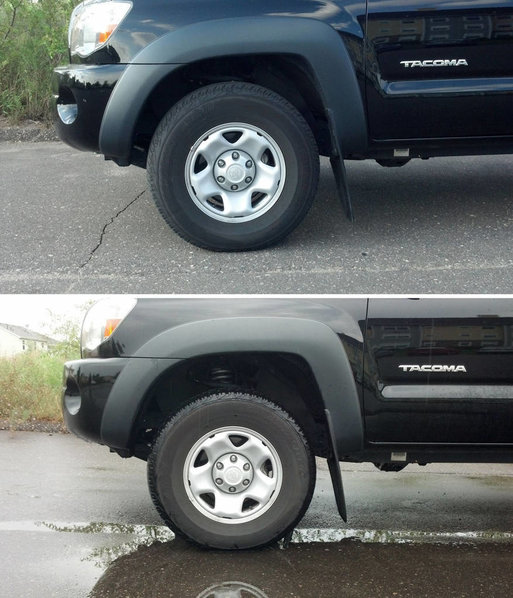

Before the new wheels. Bilstein 5100s on all four corners. Fronts at 0" with Eibach/Toytech coils. TSB packs in the rear. 1.25" lift in the front, with the rear sitting .75" higher. Pretty much looks level though.
