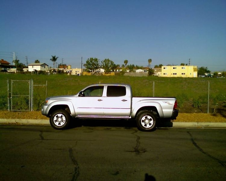

I received the suspension TSB leaf spring upgrade which brought the back of the truck up. So I installed the Bilstein 5100s at the 2.5" setting.

      Is this with just the 5100's and the stock coils and obviously the TSB? Did the truck sit level or was the front a little higher?
    • Evil Monkey
      It sat level. It looks higher because the phone camera was tilted. 5100s with stock coils and TSB.
