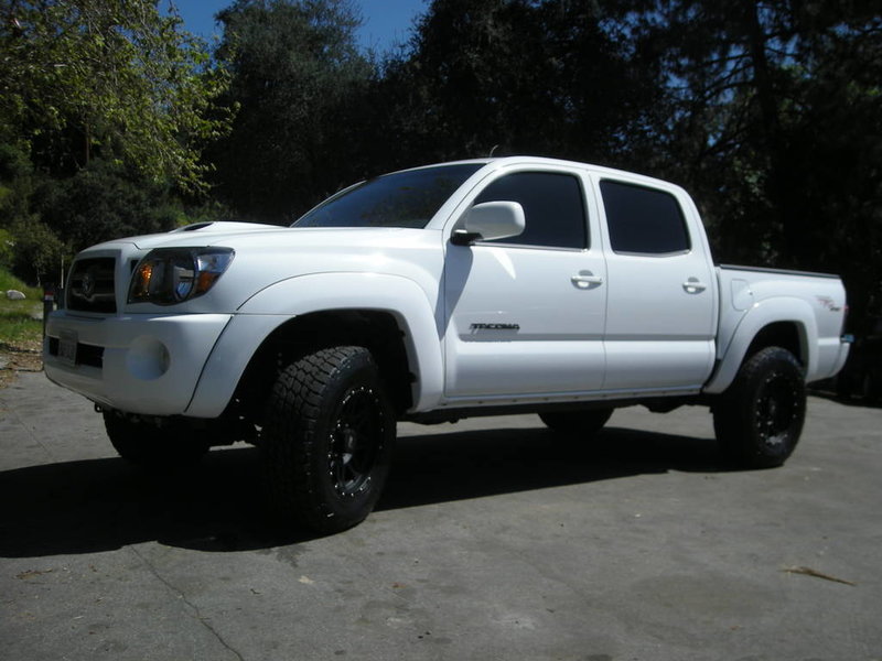

      clean truck.. so im new to all of this i just bought my 07 and like how your truck sits.. you have the billys 5100s all the way around with the front set at 1.75 in this pic? what size tire do you have and do you have any problems with rubbing? and if i get the shocks do i need anything else or i can ride those with everything still stock? thanks for the help..
    • eskamo23
      thanks! yes, i have 5100s all around and the front set to 1.75''. the tire size is 265/70/17. i do get a slight rub when backing up and have the wheel cranked to one side or the other, its just on plastic so i dont care about it. you will be fine gettin the shocks. it didnt rub untill i put the bigger offset wheels on. the ride is wayyyyyy better with the 5100s so go for it!!!!
