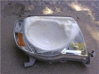

black headlight mod gone wrong!!
320 degrees for 6 minutes is toooooooo much lol, if i was going to try it again i'd say 230 degrees for 5 minutes and repeat til the lense comes off...i have HID projectors coming now so i wont be trying this mod again, just a heads up and a warning to all those who want to try it

      wow, that sucks. i wont be trying this mod anytime soon...
    • sunruner19
      Did you do this with the oven on or off. I did the mod, preheating the oven, then shutting it off before I put the headlamp in
    • jarrod06
      when i did mine i lined a box with aluminum foil cut a small hole in the side then stuck a hair dryer in it, defently much safer
