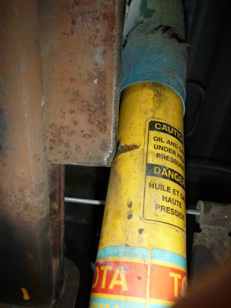

Broken Leaf
Drivers side broken leaf contacting shock Note... If the spring had broken half an inch further back it probably would have fallen right out. The only thing retaining it now is where it is contacting the shock and where it is contacting the eye at the rear shackle.
