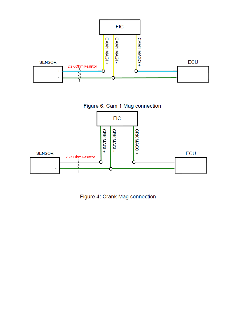

Shows the location of the .5w, 2.2K Ohm resistor used on the cam and crank signal wires for the AEM FIC
