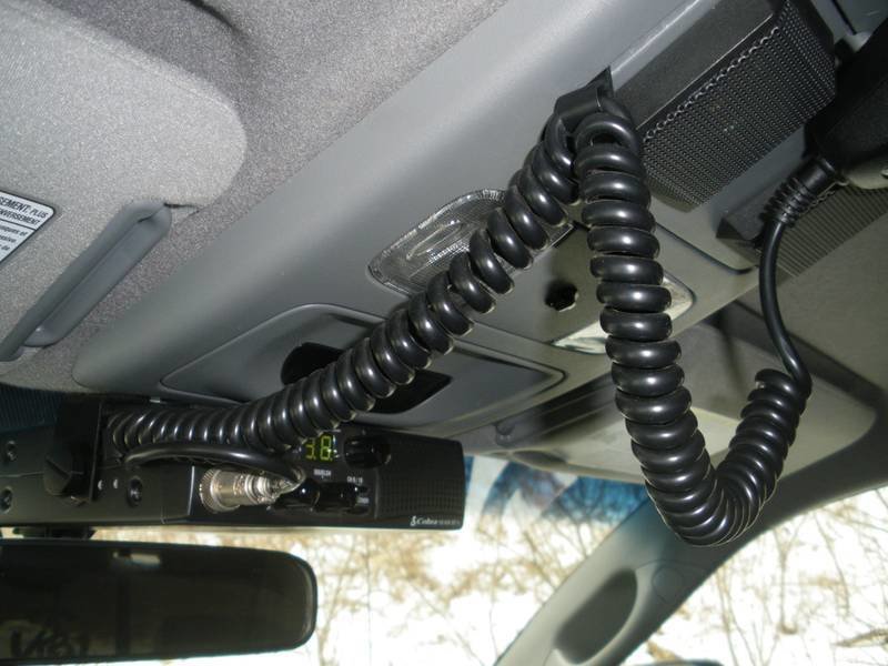

      Nope, no pics yet, but I can describe how I did it.
      CB Mount:
      I bent up 2 L brackets for an exact fit, and mounted them behind the overhead console to the sheet metal bracket up there, self tapping screws should work, I used threaded flange nuts that I had laying around. The cb bracket bolts to the L brackets. I really love having the CB up there, I think it is great and it is rock solid. The speakers are CB speakers but I really need to buy higher quality versions because I don't use them as they don't sound any better than the built in speaker. I did run the CB audio out in to my Aux stereo input, that sounds wild but isn't practical unless that's all I wanted to listen to.
      Garage door button:
      That is wired to my remote and I soldered wires to my button and on to the internal circuit board.
