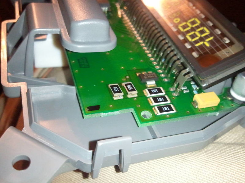

I used a Cold Heat solder tool I picked up at Radio Shack to resolder the joints. Pushed down on the resistors, touched the iron to the edge of the resistor and the pad and held for about 5 seconds until I felt the resistor getting hot.
