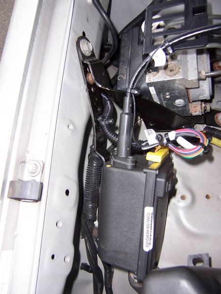

I mounted the "Brain" in the RH fender area. I used existing holes and the supplied mounting bracket. I loosened the ABS bracket and put this one underneath, I also lined it up with another threaded hole in the fender and installed a spare bolt in that hole to secure.
