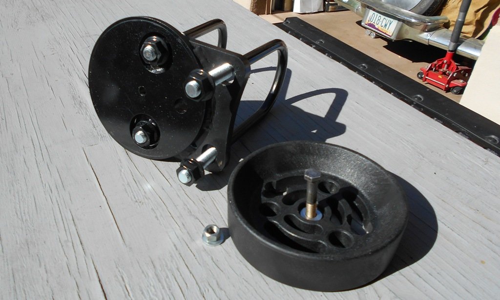

Daystar With U-bolt Flip
Circular support plate is 3/8 thick mild steel - won't bend under ordinary conditions. Welded to AllPro U-bolt flip plates. Hole for the Daystar center bolt is drilled through the base. One U-bolt in each set must be shortened and clearance cut into the Daystar cup.
