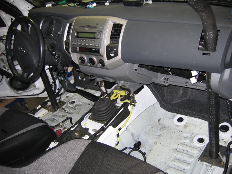

Detail of the downtubes passing through the dash.
The vent openings required no trimming to fit the 2" chromoly tubing. The side vents are trimmed and capped behind the dash. I'm keeping everything functional so I'll still have air conditioning (except from the side vents ;)) and my stereo when I'm on the road.
