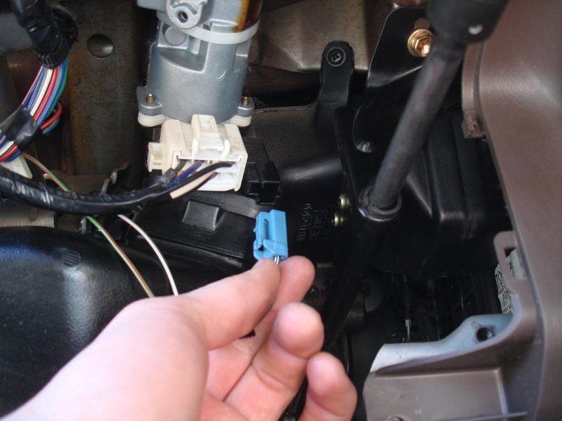

Disconnecting this wire disables the buzzer that activates when the door is open and key is in ignition. Now you can listen to the radio with the door open! I taped this connector to another wire to keep it up and out of the way. The headlight buzzer still works.
