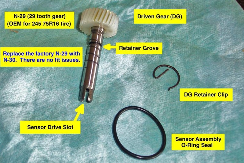

Driven Gear
This is the driven gear removed from the speed sensor assembly & housing (housing not shown)
