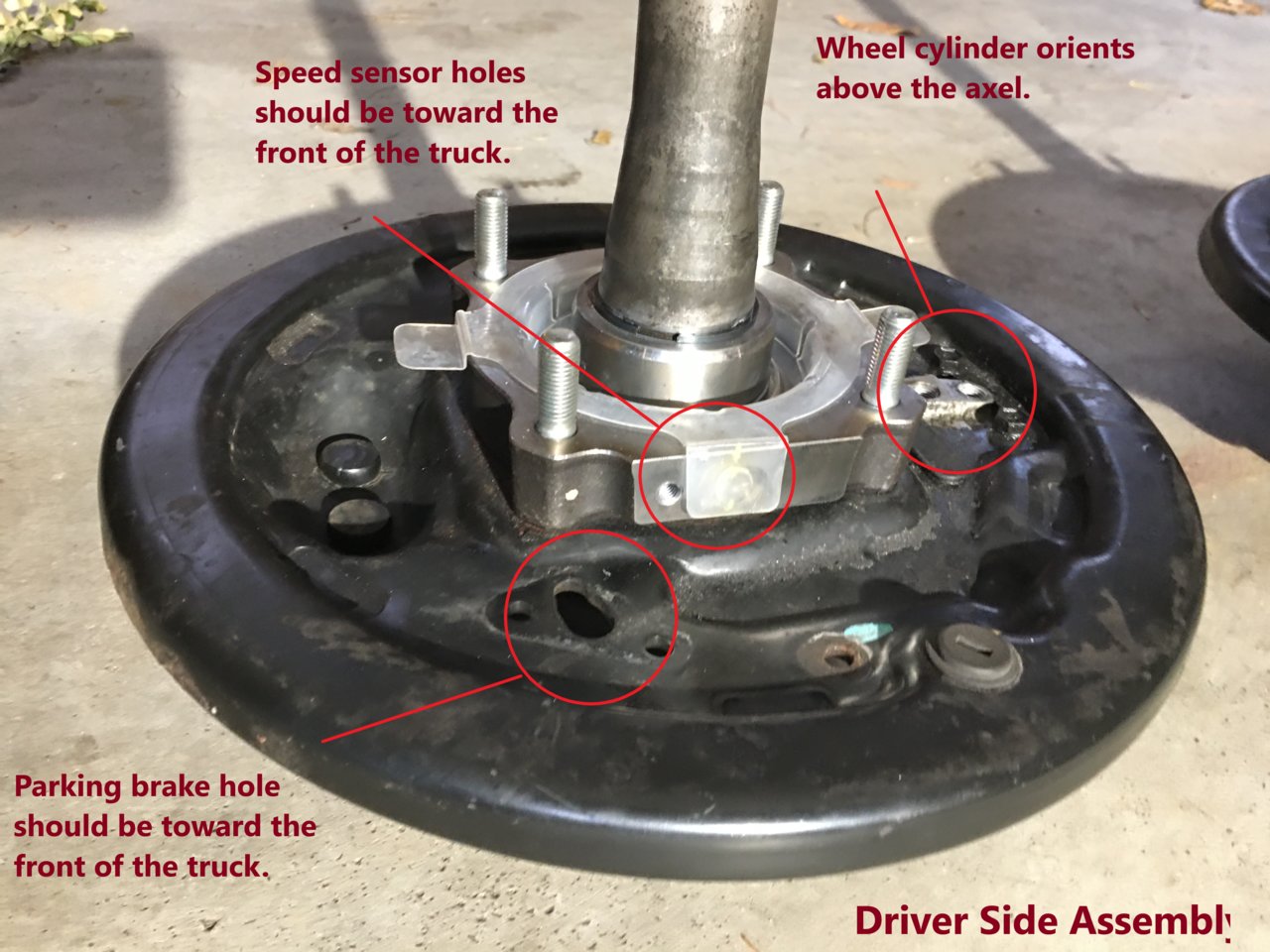

Driver side assembly was pressed on correctly. The speed sensor is in front of the axel on that side and the bolt hole is at the top where it should be.
