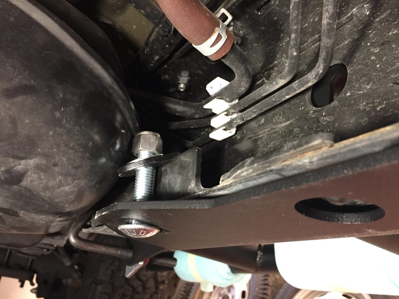

Driver side rear - J-bolt and carriage bolt
Remove the plastic gas tank skid plate before installation of bolts. Makes install much easier.
