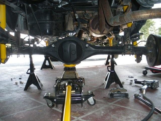

2 Jack Stands on the frame. 2 Jack stands under the axle with 1 side higher and 1 side lower working 1 side at a time. All 4 u-bolts removed, top shock bolts removed both sides, and both e-brake brakets removed. Floor jack to raise and lower axle and serve as a safety. Takes me 1 hour.
