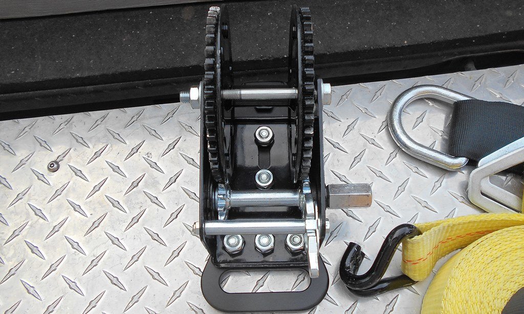

Drum Gears Had To Be Trued To Parallel
Dual drum gears are the only way to go strength wise but these aren't synced and one side runs out badly. Drum side walls weren't parallel and 90º to drum shaft. Bent to be close, works but rough. These winches could actually be very useful - but Chinese manufacturing isn't very good.
