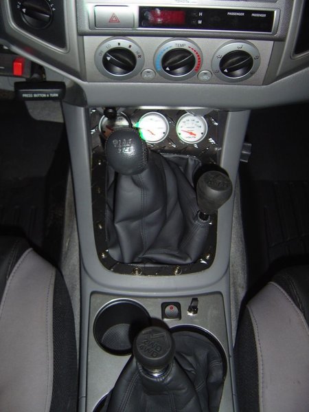

    • Bfmco7
      please explain this setup..
    • 007Tacoma
      That is one crazy setup! :eek: Got knobs?
    • Bfmco7
      what are all the knobs for. we have a gear shifter and two four wheel drive shifters!?!?!
    • The_Hodge
      independant front and rear maybe....i dunno...still looks confusing...lol...great rig though
    • rogersja63
      Sorry to take so long to answer. I've got the regular 6 sp tranny shifter of course, then beside it is the shifter for the crawler box which really just shifts between a 1:1 ratio and a stock low ratio of 2.28:1. Then closest to you in photo is the Inchworm "Lefty" transfer case shifter which replaced the stock chain driven transfer case with a gear driven transfer case. This allows me to have a 4.7:1 gear set in the transfer case and a final crawl ratio of about 240:1 compared to the stock set up which was about 38:1 in low range. I also now have 24 different gear ratios to choose from when on the trail.:D
