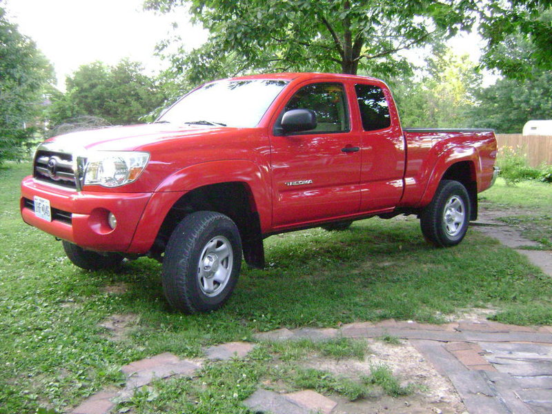

just lifted my 05 Tacoma 4x4, V6, Six Speed, access cab, Radiant Red.. Base model SR5.. with a 3" EZ lift kit- 3" blacked out coil spacer lift upfront and a Procomp 2.5" AAL in the rear -truck site perfectly level. Also: installed the 1" differential drop spacers to keep the drive angles correct.. 285/75 /16 Nitto Terra Grapplers on order and soon to be mounted and balanced.....blacked out my Toyota grille emblem and my tailgate Tacoma emblem-removed all other tailgate emblems... undercover tonneau, westin bullbar, and custom wheels to come soon....
