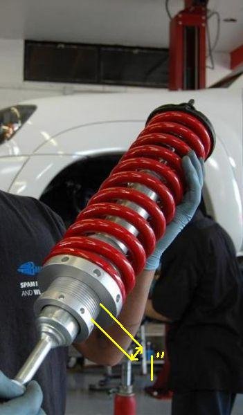

LonghornTaco
DSC_1428Large
DSC_1428Large
LonghornTaco, Dec 6, 2008
    • ozmon420
      what does that spacing indicate?
    • LonghornTaco
      The instructions for these coilovers say that 1" of thread below the adjusting nut (with the 5100s set on the stock setting) give 3" of lift. But it's kinda hard to explain sometimes, so this picture "describes" exactly what's supposed to be 1"...
