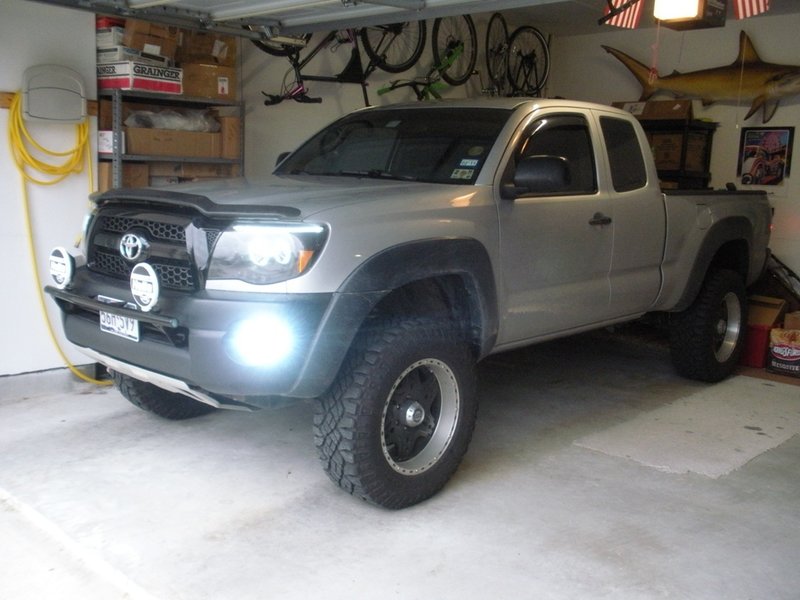

      Wow, thanks for the flashback to the old truck. That pic looks like a few months before finding my current one and stripping lots of goodies off the old one to put on new one before trading it in. Yeah, had to trim those plastic box things that hang down in front of the tire at the bottom on each side. They are part of the wheel well liners. Actually, I slit all 4 sides of them vertically and folded them up on each other then put a screw/clip thru it to keep them folded up out of the way. Also as you can see, I have no mudflaps but didn't have to trim anything else behind the wheel. Only went 1.75 on the 08 and just swapped the 3 leaf pack out for oem 4 leaf pack for the rear since reg cab. I didn't even do AAL this time. Running 265/70/16s on the 08. No need to trim anything. Here's a pic of it............JT
      https://www.tacomaworld.com/media/newmirror_1.449278/
