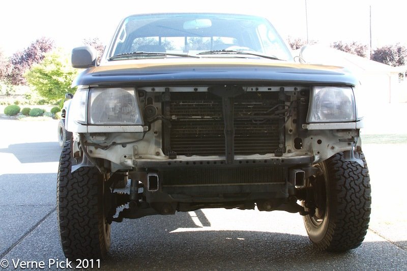

to install an elite offroad bumper on a '98-'00 tacoma, you'll need to cut off the frame ends *and* front bar (that the 3 bolts on the front of the skid plate attach to)...
