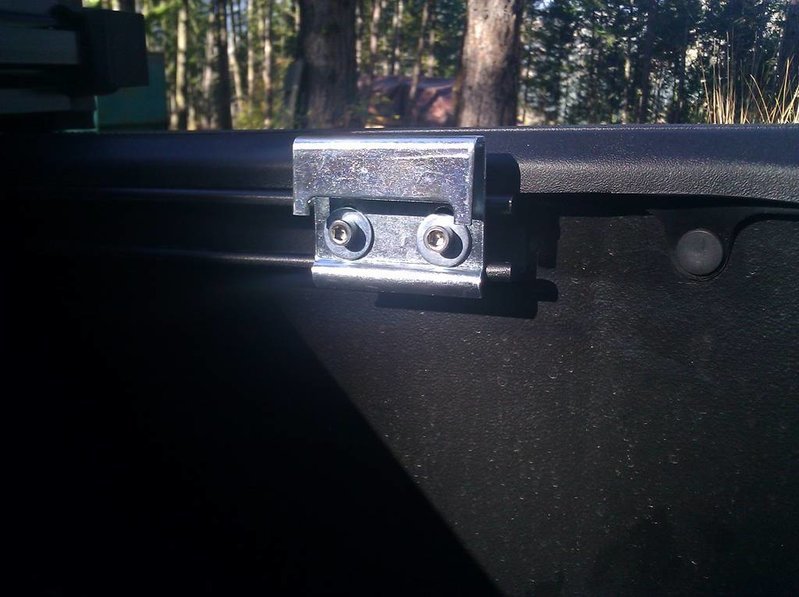

Extang Solid Fold install on 2011 Double cab with rails
This is how I mounted the adapters in the rails. I took out the plastic caps from the side rails (press tab in and slide part out) and slid the assembled adapters in from the ends of the rails. My cleats stayed in the rails, between the adapters. Don't tighten the adapters until you line up the tonneau.
