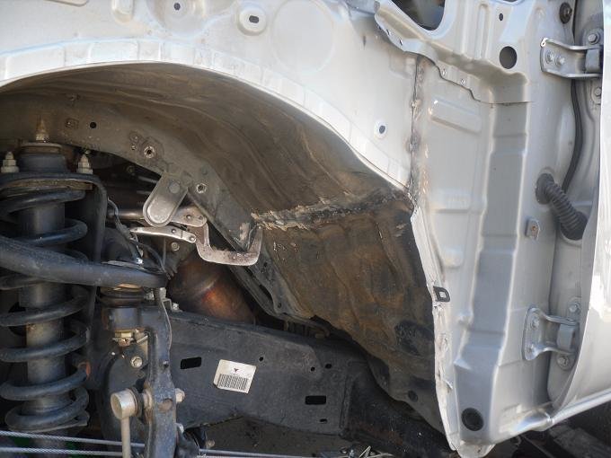

Factory weld compromise
Because spot welds for wheel tub are done through the cab floor, I cheated by welding edge to edge at this joint. There was no resulting fire on the interior either!
