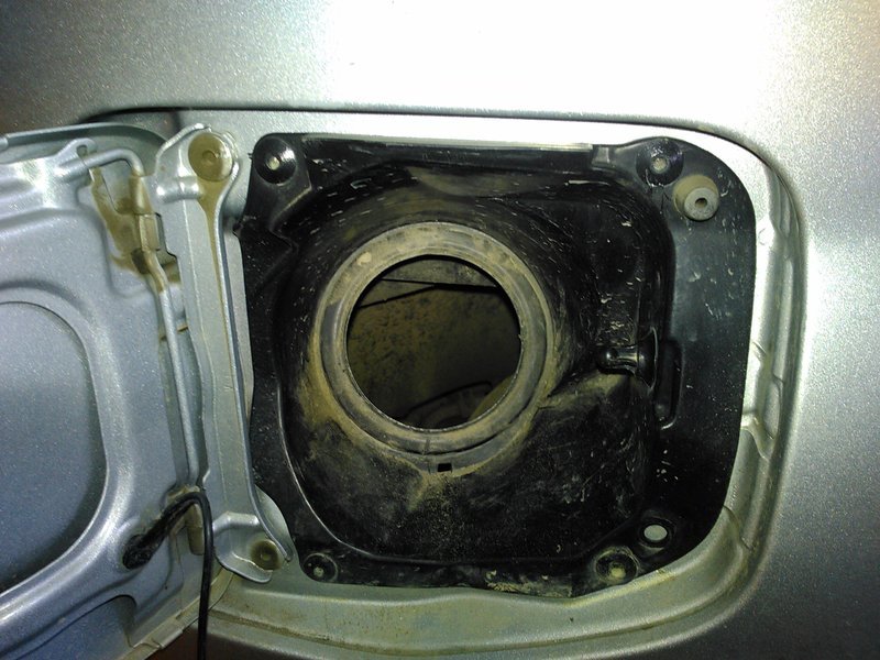

When you lift the box, the filler mouth will drop right through this hole. assuming the gas cap isn't on!. You could also disconnect it ( and the breather tube) from where it meets the frame and lift it off with the box - but it's very hard to access while the box is still in place.
