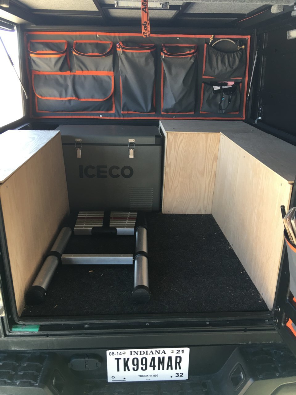

      Quick, simple build out in the back. Used 1"x2" cedar for the frame and 1/4" oak finished plywood for the sides and top. Lightweight and strong. Can stand and sit on it no problem. Wife is going to make up some seat cushions for them. Going to live with it this summer and see if we make any changes. Got a weekend in with my 80 year old father making it and about $100 in product. It's not high end for sure but works.
    • mtnsoft_tac0
      Kudos! High end doesn’t get you a weekend with your father.
      how do you like the iceco fridge?
      Bigmo likes this.
    • Bigmo
      @mtnsoft_tac0 I have no real complaints about the fridge. To be honest I’ve not used it through a entire season yet but it seems like it will preform just fine. Didn’t want to spend 1k or more for a fridge. Usually can fine a promo code for it and get it reasonably priced. It is on the heavy side but maybe all the fridges like this are heavy not sure I’ve not had other brands.
