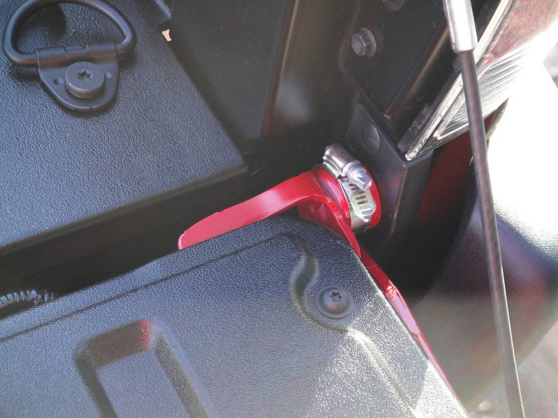

    • fiestee23
      what kind of MOD am I lookin at? I see a clamp. Sorry I have no clue
    • Fluffymonkey
      Tailgate theft mod. The clamp prohibits people from popping your tailgate out of the grove on that side and stealing it.
    • Juggernaut
      ^ Correct! I used the E-Z Hose clamp from walmart so it is even screwdriver proof.
