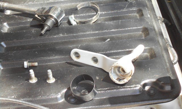

Fitting Hinge Cover Band on Tailgate
Tubing cut to match width of hinge and de-burred. Paint inside and out to stop rusting.
GREENBIRD56, Jun 1, 2019
    • GREENBIRD56
      Passenger side tailgate hinge covered with a close fitting sleeve made from exhaust tubing. Has to be disassembled to remove tailgate.
