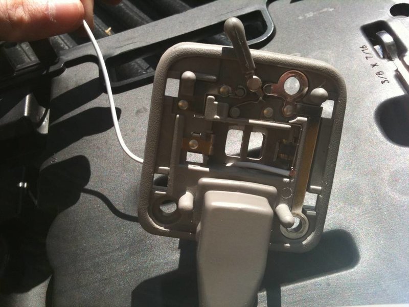

In order to make the circuit a parallel circuit, (series circuit wouldn't light up dome bulb) I had to tap in between the switch and bulb. The white wire is the wire I added
