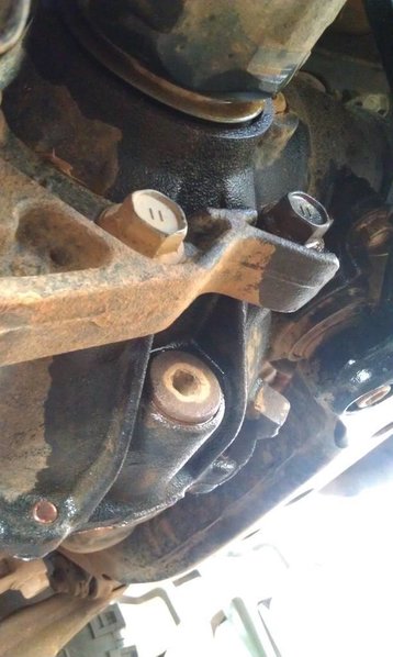

front diff leak? axle seal?
GotLift37, Feb 15, 2012
    • nightrider09
      Having the same problem with mine, noticed it at 30k, was wondering how much it cost you to fix ajd what all was wrong with it
    • GotLift37
      just the seal. the seal cost like 11 or 13 bucks. drain the front diff fluid, pop the axle out. replace the seal. install the axle fill the front diff back up with diff fluid.before u drain the fluid make sure the fill plug is able to be loosed first. incase u empty it and the fill plug is stuck.
