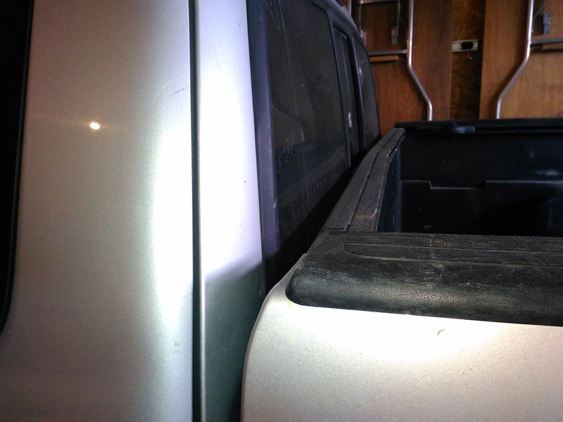

Front of box - removal
After removing the 6 retaining bolts from inside the box, the box had to come straight up. The front of the box fits very snuggly against the back of the cab. If you've run your quad into the front of your box and bent it - like I have - it takes a bit of wiggle.
