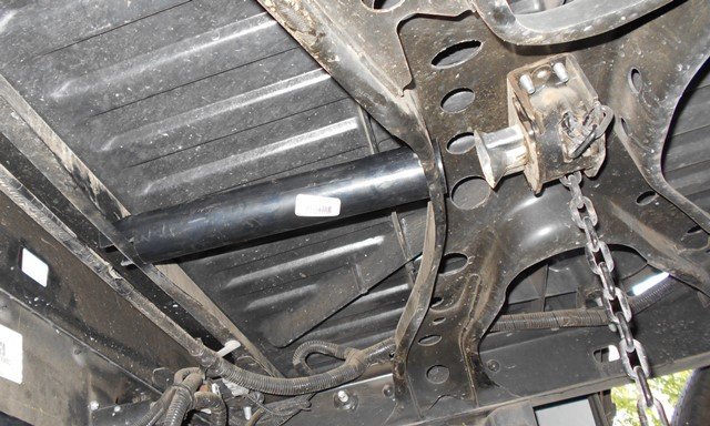

Guide Tube For Spare Lift
Plastic pipe fitted to guide the spare lowering rod into place. I've been considering fitting a drive rod that stays in place and has a lug nut welded on at the rear. I keep the spare chained to the truck with a padlock so it doesn't "get lost".
