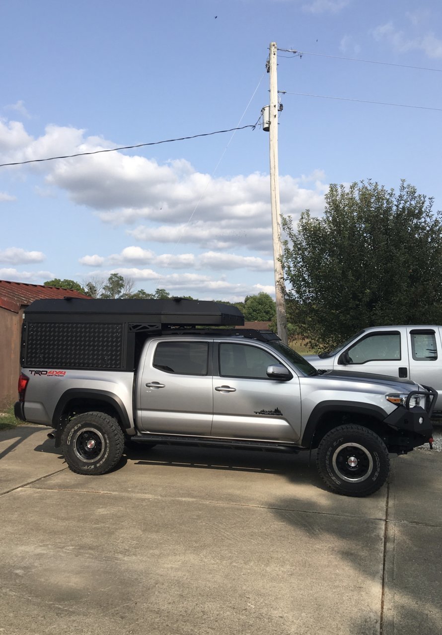

      Got my HD Dakar leaf packs on this weekend. About a three hour job for me so not bad. Gained back 1 1/4 to 1 1/2 inches in the rear over the OEM leaf pack and 1.5 inch AAL that I had before. Also did the carrier bearing drop while I was down there. Front springs I already had swapped to OME 886 and run the Bilstein 5100's all around with super bump stops front and back. Haven't put many miles on it yet but initial review is it handles the weight of the camper much better and the ride is not stiff at all feels the same as before. Time will tell but I feel like this set up will work for me.
