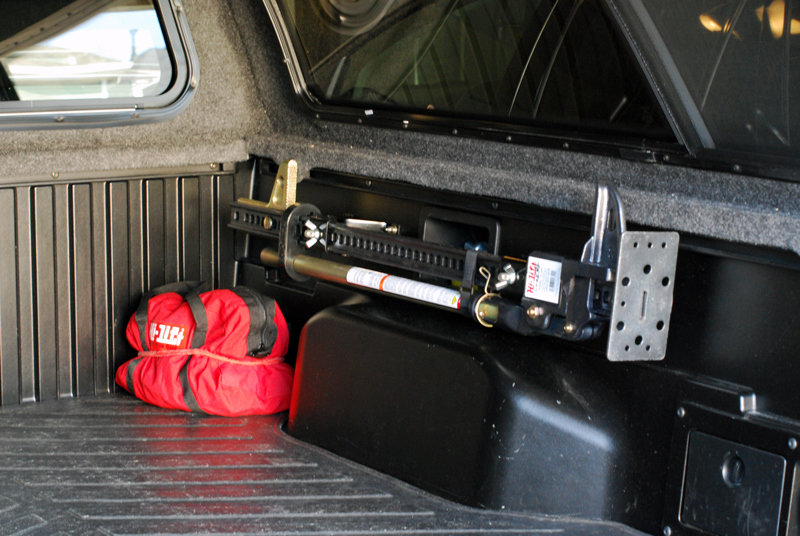

Mounted in bed with 4XRAC. Grade-8 1/4-20 bolts, fender washer on opposite side, grade-8 washer & spring washer, with grade-8 nyloc nut torqued to 9 ft*lbf. The original mounting hardware was very cheap and actually failed under tension when torquing. Mounted on passenger side to help counter-act the "Tacoma lean."
