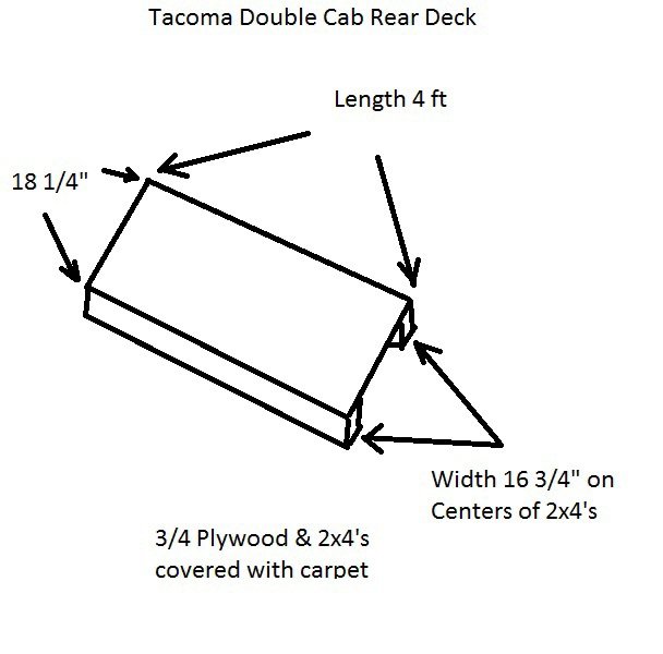

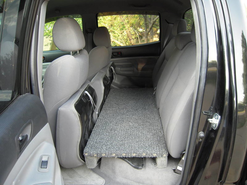

Home Made Rear Deck for my 2005 Double Cab...4ft x 18 1/4 " x 3/4 plywood mounted to 2x4's & carpeted.
