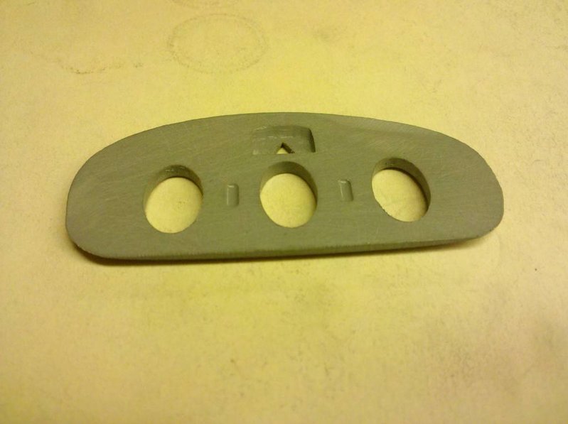

I sanded the back of the button cover and used this as a templates for making the holes. Then I taped it in place, drilled the holes and used dremel to make the holes perfect. Then trim of the fuzzy stuff with a very sharp exacto knife blade.
