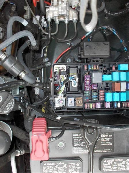

hot wire from battery to rear bed
red wire (10 gauge) connects to the nut on the bottom left corner of fuse box. Wire is 30 amp fused in-line, and is strung along frame to driver side rear light assembly. This wire is for dome light in camper shell, and has a pigtail to the 12v outlet above the driver side cubby.
