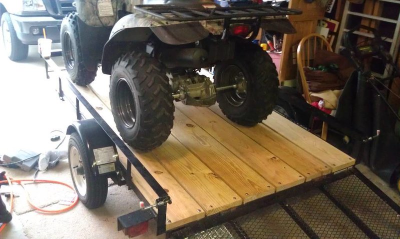

Refurbed a wire floored 5x8 trailer for my in-laws. ripped off the old wire, angle grinded welds smooth. Then cut pressure treated 2x10x8's to fit and secured with smooth head stainless lag bolts. I think it turned out well.
