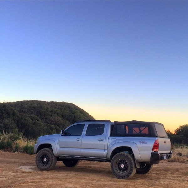

      How do you like the ko2s? And how much trimming did you have to do? Also, what backspace and offset are your methods?
    • SKULLY
      @06taco4.0 love the new KO2's. The Methods have 0 offset and 4.5 BS. I did the CMC and had to trim a little bit of the inner blk inner fender liner but not much.
