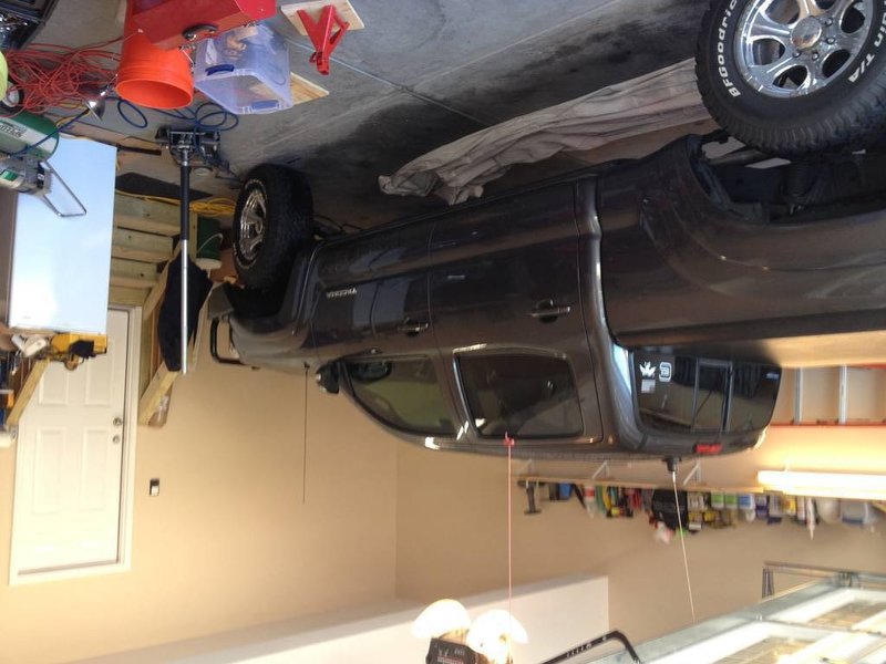

Pro Comp 3" Coil Spring lift, Wheeler's .25" spacer P side, .5" spacer D side, Wheeler's 1.5" Coil Spring isolator. Up front measurements are 24.5" both P and D sides. 2" rear block with 2" Pro Comp AAL. Current rear measurment at 26.5" both P and D.
