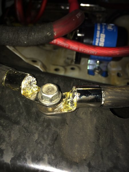

All factory grounds were upgraded along with some new grounds. Each battery has and 0awg ground to the body and directly to the frame. The starting battery's frame ground also has an 0awg ground jumped to the engine block.
