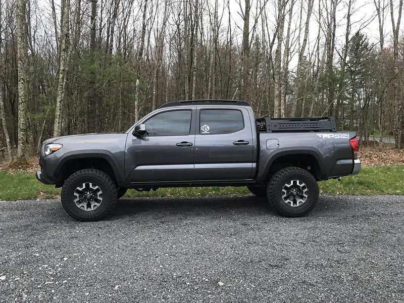

      Love the set up

      Looking real nice. Can I ask what kind of tires you have on there, and if you have a lift? I'm looking to keep mine clean like yours. Simple level or lift, but with a nice aggressive stance.
      Cheers!!

      I'm running cooper st maxx tires in 255/85/16. The lift is ome 888 coils up front with bilstein 5100s. The rear is a dakar leaf pack w bil/rcd 6112s and ext break lines. Im lifted 2-3/4" in front and 2-1/2 in rear
