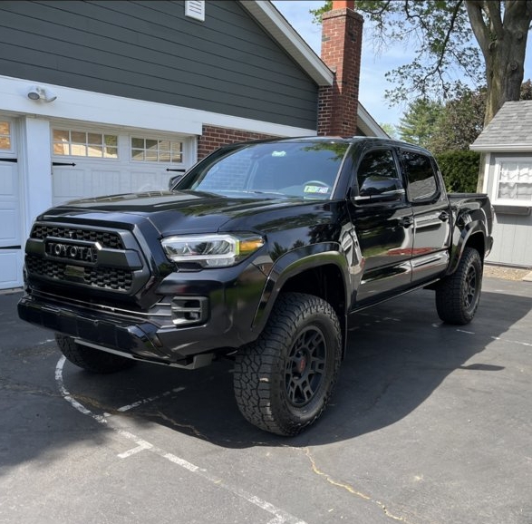

      Are those 275/70R17's on a 5100 lift on the top notch with the SEMA 17x7 +4 offset wheels?
      And no rubbing at all right?
      I just installed the 5100's on top notch and want to do 275's but I'm concerned about rubbing.
    • 4x4Taco2012
      These are 275/70/17 Falken Wildpeaks on the TRD lift, which is very, very close to 5100s. The wheels are the SEMA 17x7s but I'm not 100% certain on the offset, but +4 seems about right. I've had this setup since August 2022 and it hasn't rubbed once. I absolutely love the look, it's just right to me. Hope that helps.
