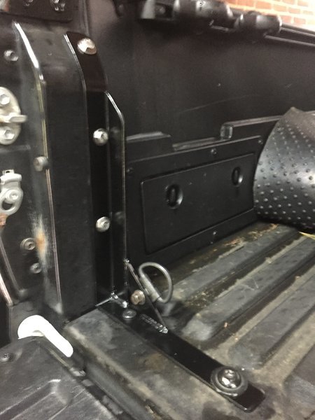

Casper66, Jun 16, 2017
    • lucky999
      i was wondering what that was for.
    • Casper66
      @lucky999 bed stiffeners. The beds on these have a tendency to flex and seperate if you have things mounted to the bed rails so these prevent the bed from spreading and /or seperating. I don't really need them as I have nothing heavy mounted to the bed rails like a cap or heavy rack or anything I'm home recovering from shoulder surgery and was bored and these have been all the rage on TW so I figured I'd make a set. I bought my truck completely stock and obviously enjoy piddling with it I've done every thing except the AAL in the back which a buddy did because I couldn't with only 1 hand to use
    • lucky999
      how is your recovery going. hope everything gets 100%. thats great you can do everything to a truck . i might need help intalling few things. i just installed a air compressor with a 2gallon air tank. now i need to install a diff breather kit. but i have no clue how to do that lol.
    • Casper66
      @lucky999 diff breather relocate is easy there is a thread or 2 on here for it and they even give part numbers I'll see if I can find it and post you a link it's only about $25 in materials. I will tag you and post the link in my build thread. Some of the idiots in Nova call on you every now and then for which I never see an answer, good for you!
