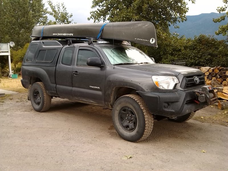

      Is this picture with your current tire setup? Just curious as I'm about to get some tires and not sure what to go with.
    • Pigpen
      @Kicnit
      Yes, these are Toyo M55 255/85/16 on stock steelies painted black. Front of truck is lifted approx. 2.5" (5100s set at 1.75). It's an amazing tire. I'm about to buy another set and have them siped and studded.
    • Kicnit
      That's great looking. I was worried that size wouldn't fit.
    • Pigpen
      @Kicnit
      There's slight rubbing on the UCA at full turn and slightly more than slight rubbing on the mudflap when flexed and turning. Not enough rub anywhere to be concerned about doing any damage.
    • Pigpen
      @Kicnit
      The key to making this size work, oddly, (other than lift) is stock wheels and UCAs. Stock wheels keep the tires inside the wheel well, whereas an offset wheel would make the 33s hit the fender - and you'd need to trim. Aftermarket UCAs correct your caster for the lift (my caster is still reasonable) by moving the wheel further back. This will cause 33s to hit the back of the wheel well - and you'd need to trim.
