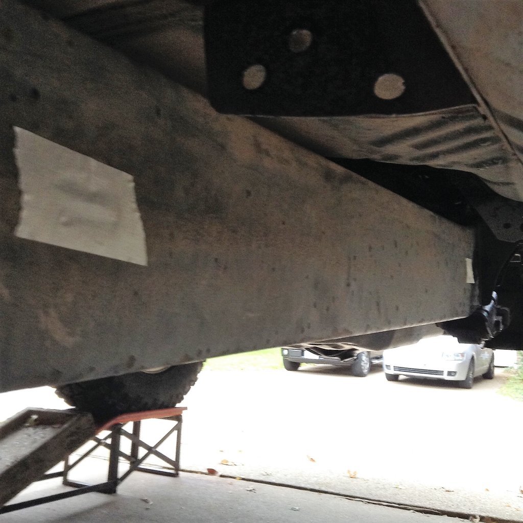

      Pieces of tape is to cover the frame holes so you can spray paint from the inside out of the frame , internal painted 1st.
    Frame Protection Eastwood and Chassis Saver
