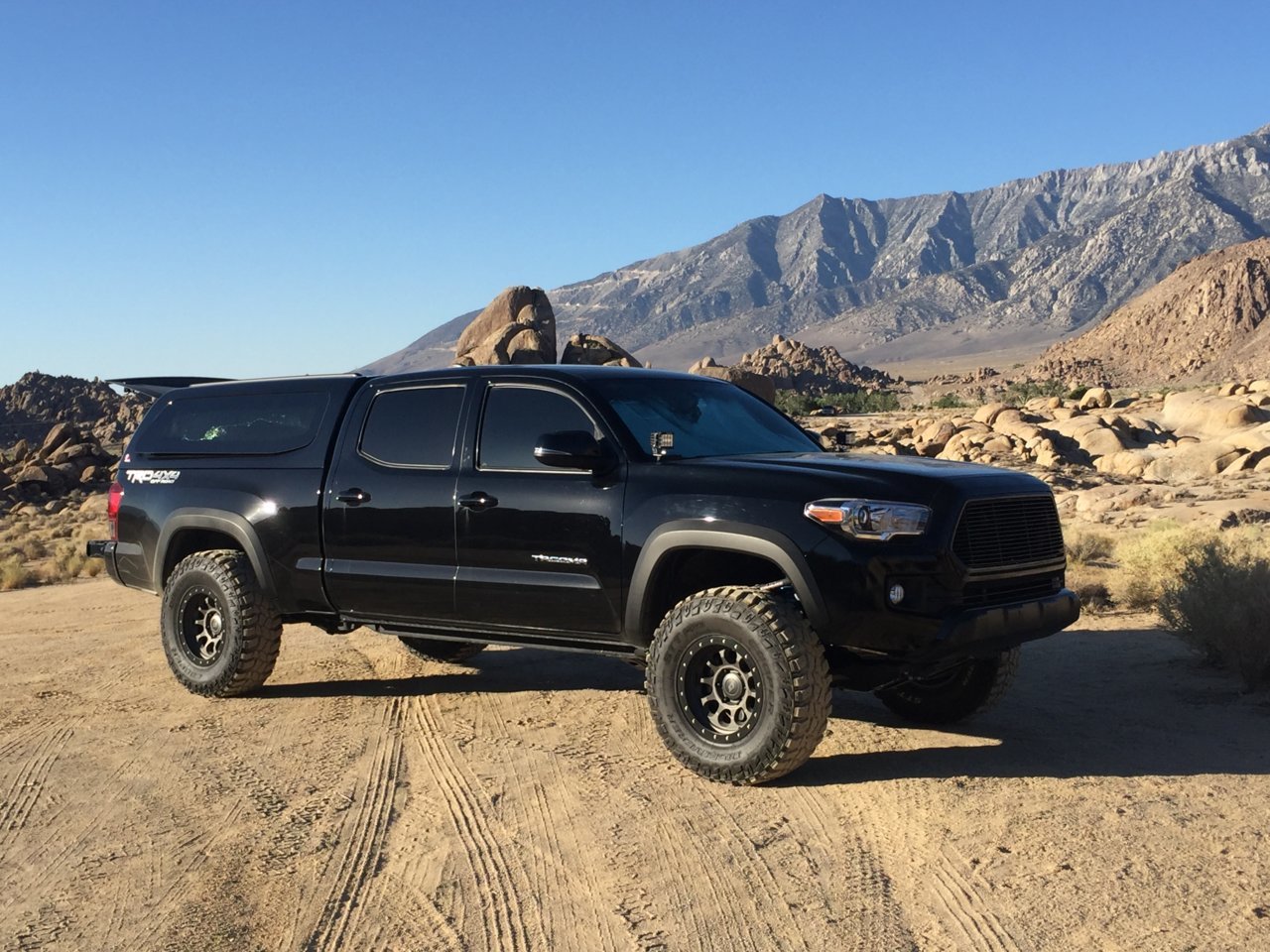

      So sick! What's your tire wheel size and lift setup?
    • TacoSauceHB
      @Gnarman Thank you man. 285/75/16 . Cooper STT Pro tires, SCS Ray10 wheels. King 2.5 extended travel coilovers + Camburg Uniball UCA's. Rear has King 2.5 ext travel but I have not installed my AAL because I fear it will ride too high in the rear so its basically stock in the rear. I was told directly by King Suspension to NOT crank the collar up too high like a lot of Taco owners do as it will cause the shocks to wear out faster and the ride will be very stiff and feel more like a billstein cheaper shock. So I am going to buy new coilovers with a heavier spring so they dont sag when they break in like mine did. So if you buy Kings , call them and ask before you adjust your coilovers lol. 90% of the guys I see rocking them have the collar cranked up waaay too high just for the looks.
