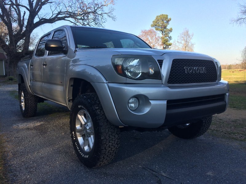

      I am new to Tacoma Forum so I am not sure if I searched well enough but I couldn't find any threads on where or how you did you grill. Did you make it yourself? Or where id you buy it?
      Also your lift if perfect. You used 5100's all around with an add-a-lea in the rear?
      let me know!
      Thanks
      bama trd likes this.
    • bama trd
      @Dasche_Riprock I ordered the plain Black mesh grill on ebay, sanded the outside part with a fine sand paper, taped up the grill and primer, then painted with a can of Toyota match paint from Autozone. The Emblem, I also bought on ebay, goes on a Land Cruiser. I had to use a jig saw and slowly cut the letters out. Then I lightly sanded those and spray painted them Black. Bought a tube of just plain Silver touch up paint and slowly painted around the edges of the letters ( there is a groove around each letter, so it's easy to do) Then spray painted a clear coat over them. I then bought , from Autozone, a tube of JB Weld Plastic weld glue and spread a light coat on the back of each letter and placed them in place, after measuring and marking the center of the grill. With the mesh, just stay in line and it's not that bad to do. I also installed the 5100's all around and since I don't go off road, I just added a 2" block to the rear. Thanks for the comment.
